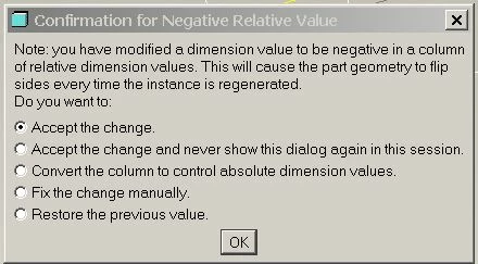

Jun 20, 2013 5:47 PM UTC
When I create a negative I get the attached message. If I pick Convert the column to control absolute value, ProE puts a dollar sing in front of the dimension symbol. You used to have to do this manually.
