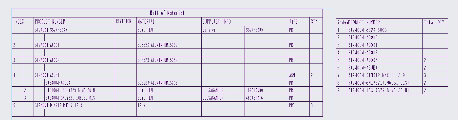

Nested repeat region BOM table QTY incorrect
Dear All,
Currently i am struggling to get the qty value in my Bill of material table correct. due to the use of nested repeat regions.
When a sub assembly is used multiple times i can not get the qty of the parts used in that assembly to represent the total amount of used parts.(see picture
I have tried to resolve the issue by using relations. but i can not refer to a value from one repeat region to an other.
Douse anyone recognize the issue at hand and have ideas on how to resolve it?
I am working with Creo 7.0.11.0.
Tomas
BenLoosliAnswer
It is functioning the way it should.
Your 3124004-ASUB1 subassembly, used 2 times, has 3 components in it, each used 1 time. It is displayed properly in your Bill of Material table.
If you are trying to get the 3 sub-components to show a quantity of 2 in that table, then you would be ordering double the number that you actually need.
The summary table shows the total numbers needed for the top assembly.
