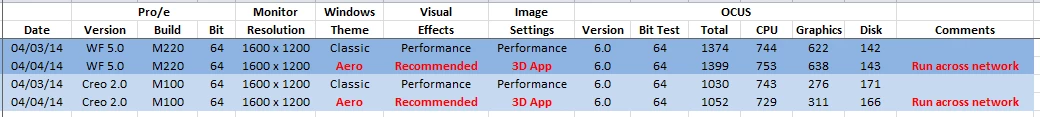

    Once Creo is loaded and running, I have been unable to distinguish any real performance impact from running across the network. Here are some older results from my testing with the OCUS benchmark. (These are not exactly “apples to apples” because several things are changing at the same time, but it does show the relative similarity.)
    [cid:image001.png@01D05D73.D875DED0]
