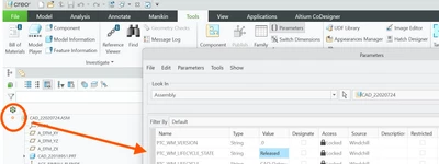

I have an odd "thing" in Creo and/or Windchill.
When I create a new Object (like a Assembly) and I edit its parameters, the lifecycle state is set to "Released":

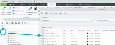

only if I upload the file, the correct state is displayed:

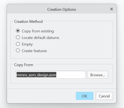

OK, it seems, that this behavior only appears, if You create a subassembly within an assembly.
So my educated guess is, that Creo copies the state from the existing template at this step:
Right after its creation, the new sub assembly even shows the Version "D.2", which is the template's Version
But as soon as I save the new sub assembly, its version gets changed to ".0"
I consider this as a Bug in Creo, since not all attributes are set to a "default" value on creation and/or first save.
