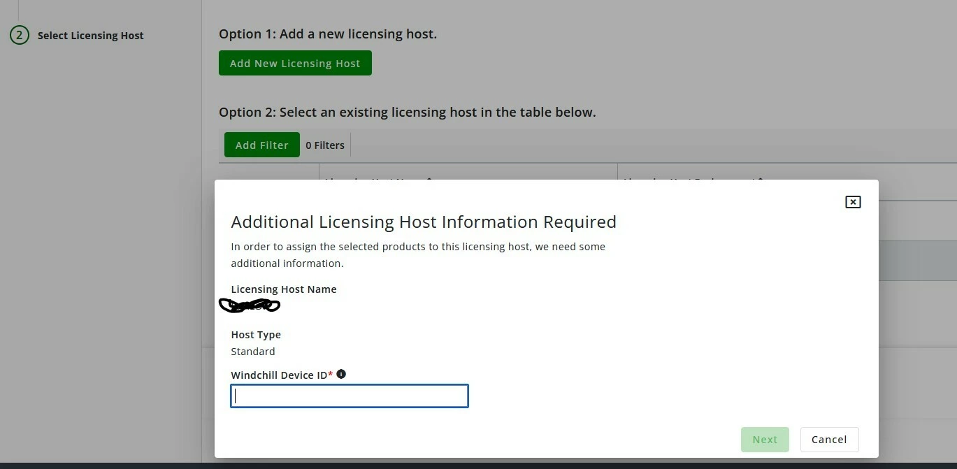

I wanted to move my Windchill licenses to the new host but it ask for a “Windchill Device ID”. I not sure what to type for that. Do I need to ask PTC for that or can I use my own ID?

Mahesh_Sharma
22-Sapphire I
May 18, 2026 2:45 PM UTC
Hi ​@UO_01
I think Article https://www.ptc.com/en/support/article/CS412695 can help you with Windchill Device ID.
