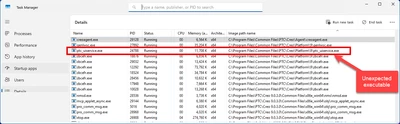

After test installing the latest Creo 9 Platform Services Update Patch and the new PTC Universal Browser Utility as documented here (Creo and WWGM CEF Patch Table | PTC), I notice a new PTC executable running with Creo Parametric when signed in to Windchill, located in the Creo Platform Services load path.  I cannot find any mention of "ptc_uiservice.exe" in the PTC Knowledge Base or the PTC Community.
I have opened a PTC Support Case to add it to CS245546 and CS110511 with further details.
Does anyone have any information on this new executable?

PTC responded to my requests to update CS245546 and CS110511.
CS245546 was updated with ptc_uiservice.exe added to the list of executables that should be whitelisted by antivirus or firewall.
CS110511 was not updated with any information

Follow up on this:
