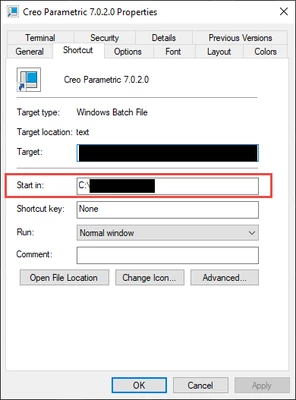

Nov 7, 2022 3:49 PM UTC
If you right-click your Creo shortcut, what is the "start in" location? I'm guessing that it's now pointing to C:\Users\Public\Documents. Was that the location you were using before? Can you use another location instead?
