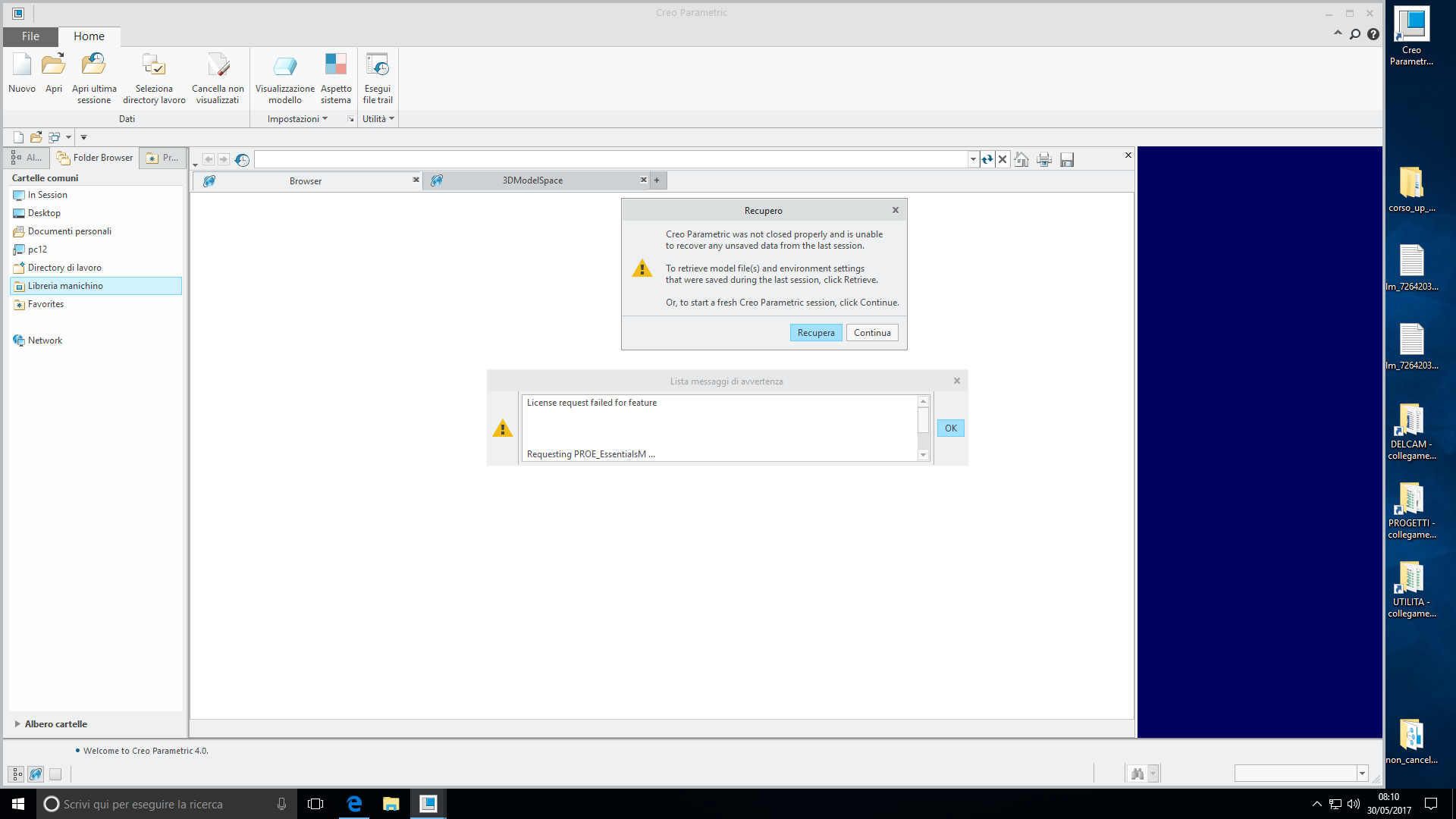

Non riesco ad avviare CREO
2-Explorer
May 30, 2017
Hello Maurizio Bigaran
it looks like your licences stayed blocked on Flexnet server. Try to restart flexnet server...

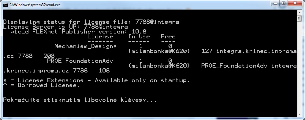

What licences are free or in use?
See Creo instal directory .../Parametric/Bin/Ptcstatus
Regards
