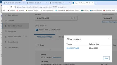

Go to the dell site and search for your computer, I was able click on the older drivers and find it
Or link below:
https://www.dell.com/support/home/en-us/drivers/driversdetails?driverid=v0p2r&oscode=w2021&productcode=precision-17-7770-laptop
Or link below:
