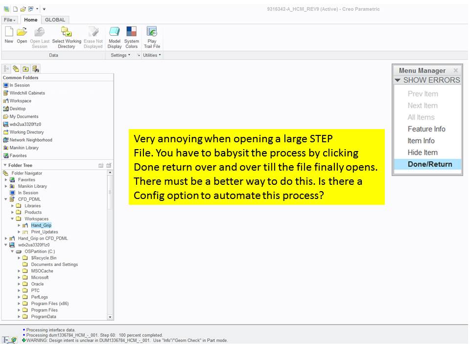

Opening large STEP files
When I open a large step file is there a configuration setting so I don't have to baby sit my file opening. STEP file size is 800MB We are using CREO 2.0, M100

It worked !
Took about 40 min.
Thanks for the help.
May 13, 2014 2:21 PM UTC
Change the config option
show_geom_checks_on_creation no
and this issue will disappear.
I do not recommend leaving it that way or this will by-pass warnings on geomchecks when modeling. I have added this to my "config favorites" to it can be set to no when importing, and yes when modeling.

Thanks Bill, this will help immensely.
