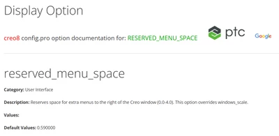

December 10, 2025
Don't know if this will change the position of the window, but maybe this will affect the size.
