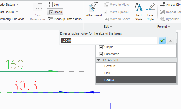

Option to set radius value for the size of the break in dimension extensions lines
I have found that sometimes the value is set, sometimes not. Where can I define the value? So far I could not find any configuration option.

Hello Joshua,
it seems the value of the DTL option wittness_line_offset is used by default.

Yes that's right, but this option also defines the distance of all witness lines to the body edge. Unfortunately this distance according to DIN is defined 0.
