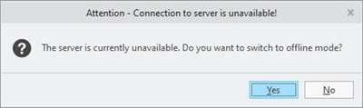

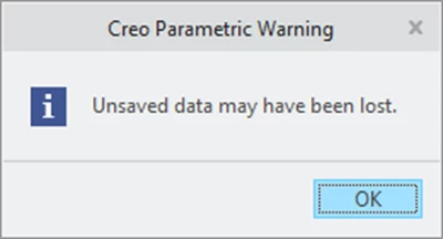

Often, I am faced with this window:
Problem is, its yes/no buttons are not responsive because the system is waiting for acknowledgement of this dialog box:
Sometimes, there are several of these warning boxes, and often, they are hidden behind other windows and not accessible except via moving them "to the front" via the taskbar manipulations.
I am wondering if there is a config.pro option to prevent the application from displaying this annoying (on so many levels) warning dialog box.

you have following options:
1.] resolve problems in communication between Creo session and license manager (this can be difficult)
2.] borrow license (Creo session that uses a borrowed license does not communicate with the license manager)

Thanks @MartinHanak for suggestions; with me connecting  / disconnecting to the VPN and the computer going to sleep / waking up, the connection to the license manager is intermittent by design.  Besides, I often use borrowed licenses and still get the message about unsaved data being lost.  So I'm not super interested in changing my habits to prevent the (stupid) message from showing up; I repeat that I sure don't see a point to this warning being broadcast and insisting that the user acknowledges - there is no choice to be made, it doesn't tell me how it happened and does not suggest what I can do to stop it from happening.  IMO, this is yet another demonstration of PTC not testing their product and being oblivious to negative user experience.

There is a config option that is likely not what you want but you can try it.
suppress_license_loss_dialog yes
