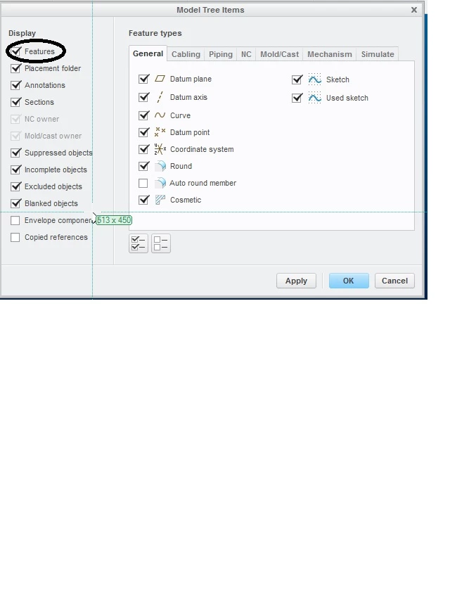

hello
I need a parameter for features and placement folder in config fille
thanks in advance

Please explain....
Placement folder?? Are you looking for something which will provide the information about data location on disk???

in atachament
April 11, 2018

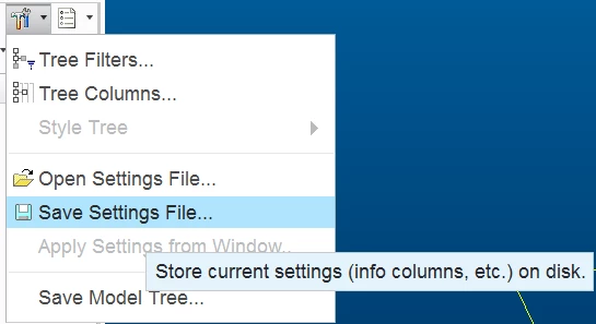

it looks like you want to see features in Model tree in Assembly mode.
  1. use Tree Filters command
  2. use Tree Columns command
  3. use Save Settings File command
  4. in config.pro define mdl_tree_cfg_file option (value = path to file save in step 3.)
April 10, 2018
pro_group_dir X:\PTC_Settings\Features
