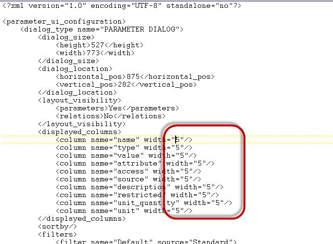

parameter table
I updated a parameter table to what I want to see for a model and saved it to use for future models  (rp_config.xml). I also put “parameter_dialog_setup_file” to “config.pro”. When I go to create a new model, the new parameter table is not there automatically. I also did load config. to the rp_config.xml, and that did nothing.

Ok, now it is clear.
rp_config.xml with config  parameter_dialog_setup_file is to setup customize parameter table change in columns and width will record in file.
To have defined parameters when creating new parts you can update the template part.

Can you upload rp_config.xml in post?
SkyKing10-MarbleAuthor
Jan 8, 2016 3:27 PM UTC
Should show below.
Mahesh_Sharma
22-Sapphire I
Jan 8, 2016 8:46 PM UTC
I think you would like to control the width of column in parameters. If this is correct, I checked your file however that contains less width.
You can open the file in text pad and define the column and that should work.
