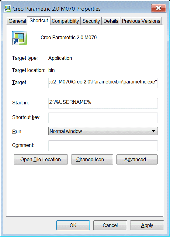

To enable user to access his personal directory, put the appropriate information into Start in field of shortcut used to start Creo Parametric 2.0. For example Z:%USERNAME%

Scott,
I have installed Creo Parametric 2.0 M070 into C:\PTC\Creo2_M070 directory.
PTC installer created default config.pro in C:\PTC\Creo2_M070\Creo 2.0\Common Files\M070\text directory.
I added FILE_OPEN_DEFAULT_FOLDER WORKING_DIRECTORY into it and attached it to this reply.
The second attachment is a screenshot of shortcup definition.
