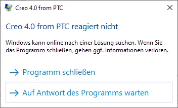

Parametric Student Edition freezes and then crashes on all Computers
Hello Everybody,
is there currently a known major issue with Creo Parametric Student Edition 4.0 ?
The symptom ist, Creo starts but after the first click it freezes and after next click it crashes. (no matter where you click).
This happens currently on many private PC's of my students since Friday and since today even two of my PC's are effected.  I also have the educational version installed on one of my computers and this version runs fine.
Operating System Win10 20H2, all updates.
Tried new installation, cleared the cache, nothing helps...
I dont know how to run the next lecture with this problem.

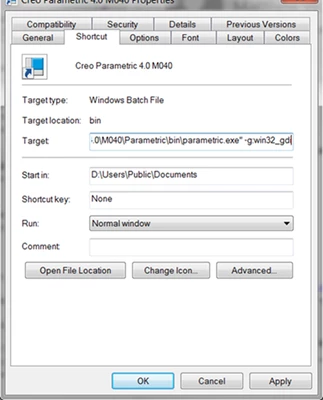

If the problem persists, you my need to lower the graphics:
Right-click on the PTC Creo Parametric shortcut on the desktop and go to properties. Add space after the existing target path and then -g:win32_gdi. Click on apply and run the Creo.
Alex
