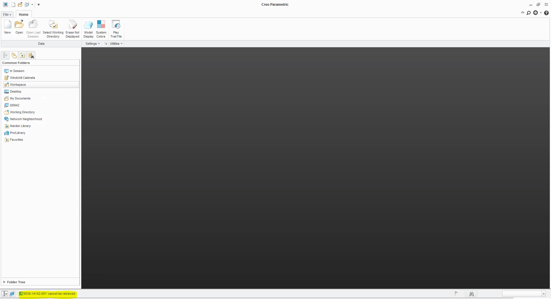

I could open parts fine in Creo 3 M120 / WC 10.2 fine for years but then recently I get the "cannot be retrieved" error whenever I try and open something from my workspace.
I have tried the following so far:
1. Using another PC - same error
2. Logging in with another user on my pc - works fine
3. Reinstalling Creo 3 M120 on my pc - error persists
4. Clearing cache - error persists
5. Deleting all existing workspaces and creating a new one - error persists
6. Deleting user and re-adding in WC - error persists
I think it must be a Creo agent issue or something similar? I have run out of ideas...

  • export part to local disc
  • open part from local disc
  • open part in Notepad
    • check Creo version information
    • check whether part is corrupted
If you can upload the part, I'll try opening it.

Hi Martin,
It is not a specific part, it is just any part I add to my workspace from windchill.
Other users can open the same parts from their PC and I can also on my PC with another WC username, but just not my own WC user login details unfortunately

please do simple test:
  • export part to local disc (from browser window)
February 23, 2024
Sounds like a Windchill permission issue. Check with your admin for your permissions on the context that has that file. Check that your workspace is actived.
I was going to say that maybe the file was saved in a newer version of Creo, but your #2 says that is not the issue. Also the error message is wrong for opening a newer version file.
