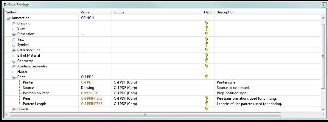

PDF size automatically created by Model Manager?
Is it possible to change the sheet size of the PDF that is automatically created by Model Manager / Drawing Manager when saving the drawing in Creo Elements Direct Drafting 18.1?
We use B size (11x17) foramt and when using Store All, the PDF that is created is A4.
I'm assuming that it's possible, because previous revisions of drawings have the correct size, but when saving a new revision or a new drawing it now saveas as an A4 size.
Anyone able to help with this?
Thanks!
Mike

I'm not sure which script is setting the size to A4, but I did discover that PLOT_FORMAT and PLOT_VIEWPORT determine the size. So, I can at least change those manually and save at desired size.
Mike
Aug 25, 2014 10:54 PM UTC
We have some customization which changed the default size from A4 to "A", plus a lot of other customization. I can't tell you exactly what the process is because we have some much other customization. But I can tell you that we have a file called "am_Plot_PDF-US.lsp" which specifies a printer to use: ":PDF_US_A". And we have a file, "am_Plot_PrinterStyle_PDF_US_A.lsp" which specifies the paper size (as "A", the orientation, and the type as ":PDF". I believe that the files were created by just going into the Print menu, setting the printer type to "PDF", and then adjusting the paper size and other parameters.

Dec 11, 2014 1:27 PM UTC
What have found that the default printer setup determines how the PDF is created in ModelManager. We set up our own printer style and made it the default printer. Now all of our PDF's generated for ModelManager are the same.
