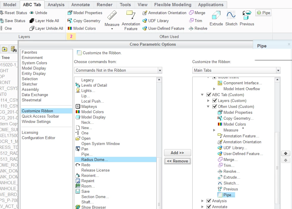

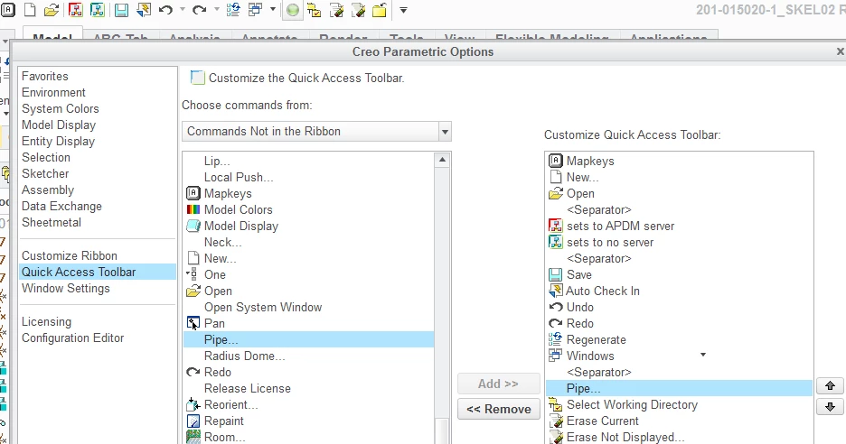

You can add the “Pipe” command to the Toolbar or Ribbon;
The first picture shows adding it to the Toolbar and the second picture shows adding it to the Ribbon (create your own tab to add it to), it just shows up as a green ball;
