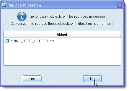

Hello ALL
I would like some inputs on how you use Pro-Piping with Windchill. It
looks like Pro Piping may have issues with Windchill. When creating a
pipe solid feature pro piping creates a new part to place the solid
feature in. Pro Piping will not use the same part file again to create
solid pipe features in. If pipe solid fails, which they sometimes do
and you ever delete the pipe solid, pro piping will force to create a
new part file number to place the new solid pipe feature in. Windchill
tracks all part names and will not let you create a pipe because part
name is in use. You have to create a new part name. This can be a real
problem for configuration management and drawings! You cannot delete
the pipe solid part from Windchill, if it is on someone's workspace
etc..., deleting a part in Windchill is basically impossible.
My question is why does Pro-piping not
just give me a warning, "pipe solid part already exist,
overwrite/update? Yes, No" Any better work around or config options out
there would be appreciated?
I am facinng this issue now, How to replace all that in windchill existing part?
Could anyone help with this to fix?
Regards
Viswanathan.K

  6. When prompted with the Replace in Session window (shown below), select NO. At this step, Creo is attempting to put the failed pipe back into the assembly. We do not want this. Instead, we want to keep the new pipe in the assembly so we select NO. The failed pipe will still be placed into your workspace, but the new pipe will remain in your active piping assembly.replace_in_session.png

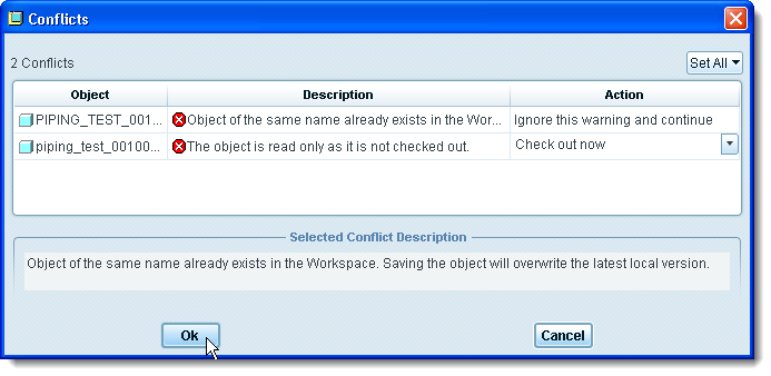

  7. Save your piping assembly. This will save the new pipe and overwrite the failed one in your workspace. Depending upon the options you have set in Creo, you will be presented with a dialog box similar to the one shown below. Allow the pipe file to be checked out. This will check out the pipe solid, save the new pipe over the old one, and complete the process.
Once you've completed this process, Check in your work. The new pipe will now replace the old pipe in Windchill and in your piping assembly. As I said, this is a bit of a chore but it does work. You can reuse the same pipe names over and over again without making useless pipes that stay in Windchill forever.
