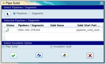

Naming
Problem Statement
When naming pipe solids and assemblies piping design uses a naming
convention defined by the user via a config.pro option. However there
is no ability to set the naming convention to use the Windchill naming
convention forcing the user to manually overwrite the auto generated
piping name with the name generated by Windchill.
Solution
Pipe solids:
Mechanical Piping
Configuration option pipe_solid_label_format default /auto
"Auto" means using standard naming convention (auto numbering of
Windchill or prt####).
Default = non defined value and system will use hard code naming format
spec driven:
UI Change
If auto is set, then the label displayed under solid name should be
blank.
If option is "pipeline" then segment name in the UI is available.
If option id "segments" then the segment solid name will be displayed.
Solid name panel is available in both option for user defined prefix.
Sub assembly:
Same as solids. There's no config for mechanical piping
In spec driven using the config pipeline_assembly_name_format. Auto,
default or user defined
"default" means using the pipeline_name as the sub assembly name
"auto" means using standard naming convention (asm0001..).
"user Defined" user can add their own prefix
Note: Name is always editable thus user can manually override settings

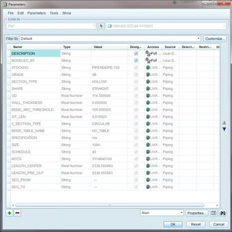

Piping parameters
Problem Statement
Piping parameters such as OD, Stock, Size etc are stored in the pipe
centerline meaning they are not stored in the pipe solid *.prt file.
When the pipe solids are checked into Windchill there are no attributes
thus it is very difficult to investigate and search for the pipe solids
and generate detailed BOM's.
Solution
The parameters Length, Segfrom /to, Sockno, Grade, Section Type, Shape,
OD, Wall Thickness, Bend Arc Threshold, Wt_len, X section type,
Rectangular height, width and angle, Bend table name, Specification,
Size, Schedule, MCCS, Id, Pressure, and Work Pressure will be added to
newly created solid parts during the pipe solid regeneration, and
updated upon any regeneration. Only relevant linestock parameters will
be set (e.g. when changing a solid from rectangular to circular, then
the parameter RECTANGULAR_HEIGHT will be deleted).
The parameters will be locked as they will be overwritten at each
regeneration, thus a user change are irrelevant.
The source type of the parameters should be "Piping" for the parameters
of the linestock feature (available in std hose project).
For "Length" and "Seg from/to" which are calculated for drawing tables
or info require new parameters
LENGTH_PRE_CUT
LENGTH_CENTER
SEG_FROM
SEG_TO?

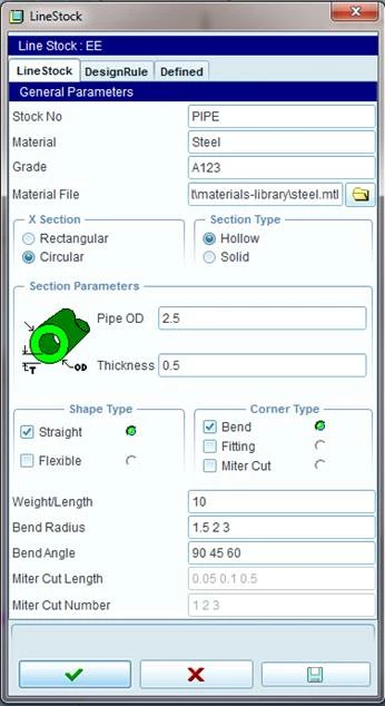

A new linestock parameter to hold the name of the material file and add
a browse button to allow the user to browse to a material file
name = MATERIAL_FILE
default value = Empty string
Linestock UI change to support this parameter:
(existing parameter "MATERIAL" is used in spec driven for a material
description)
With the introduction of the material library there are now two sources
for the density (material file or weight/length). This will enable the
user to be able to calculate a dry weight using the material file and a
wet weight using the weight/length entry. To control the source data a
new configuration option has been introduced.
If the material file is not longer available upon solid regeneration the
material parameter will become UNASSIGNED.
If the material information is updated (new file or changes to the file)

mcat file. for e.g: text/piping_data/master_catalog/pipe/pipe_steel.ptd
The system will look for the material file in mcat file
(pipe/pipe_steel) or in piping_material.ptd (by that order). If value of
the material file is missing, then old behavior will be used.
In the material file the column name will be MATL_FILE
If column is missing or value of a cell is missing, then old behavior
(i.e. no material is assigned to the part).
Units: units are kept in the material file itself. It seems we do not
have to define the units in our spec db.
