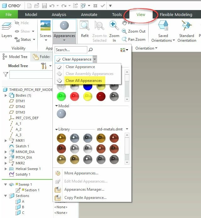

    It appears to invoke this command from the GUI.
    Clear all apearancesClear all apearances
