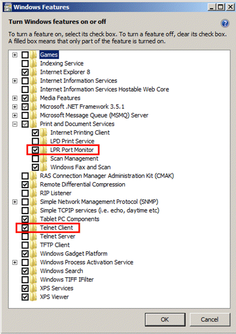

Jan 19, 2012 4:58 PM UTC
Erik,
in Windows 7 you can activate lpr and telnet command using the following procedure:
> Start
> Control Panel
> Programs
> Programs And Features
> Turn Windows features on or off
> Check LPR Port Monitor
> Check Telnet Client
> OK
