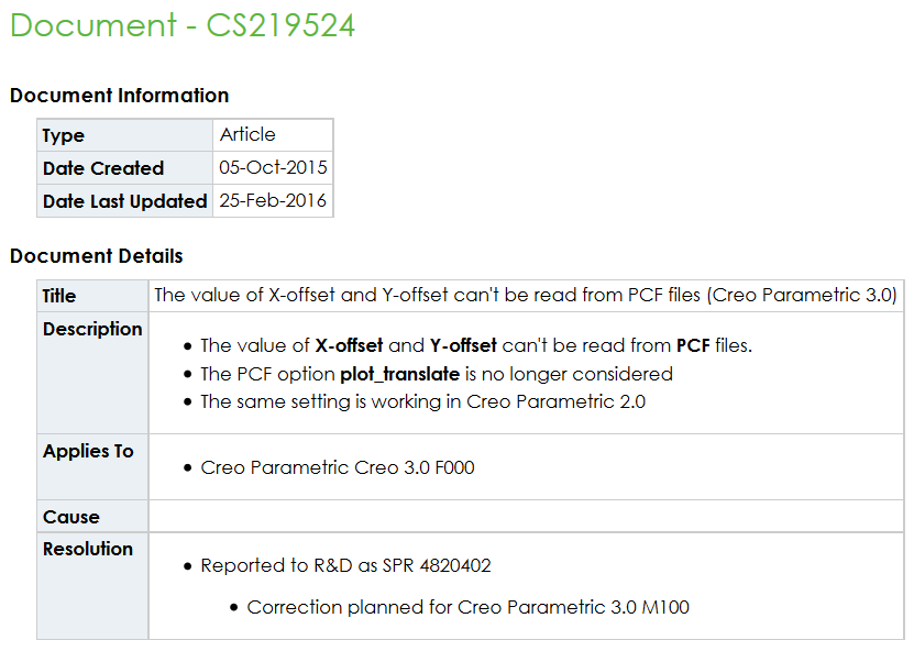

From creo 2 the plotter config would accept a X and Y Offset number (5 each for us)
Now we have to manually enter this, but i cannot see anything in the notes to any changes for this.
Anyone have any ideas?
Best answer by MartinHanak
is https://support.ptc.com/appserver/cs/view/solution.jsp?n=CS219524 describing your problem ?

Yep, exactly the issue, thanks for the fast response mate.
