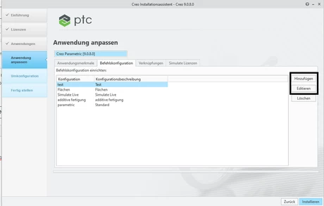

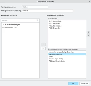

Thats how we were doing it. At the install you can create different start Profiles with different licenses. This is the german view, but should be looking the same in your language.
Just edit or add an command configuration and select/deselect your license packages
May 22, 2024
This does not really work. I have the psf files created and the Live Simulation tab is still present and when clicking on it, the license is pulled. The psf works in the sense that it does not automatically load the Live Simulation when starting creo but doesn't prevent it after that. Is there a way to call out a ui file in the psf?
