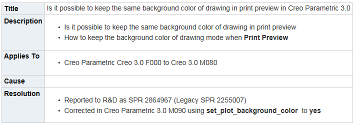

I always set the scale to custom at 94% for each print I create.  The other thing that EVERYBODY hates is the white background with yellow text and object lines in the print routine.  I saw a posting recently that stated it would be corrected in Creo 4.0.
Bob
March 11, 2016
It's actually corrected in Creo 3.0 M090, due out on April 13th.
https://support.ptc.com/appserver/cs/view/solution.jsp?n=CS197191
