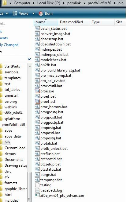

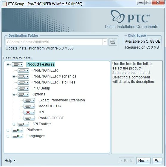

Maybe someone can help me here since PTC helpdesk is useless. I am trying to to run Pro/batch and as you can see from the attachments, i dont have pro_batch.bat in Wildfire 5.0.. I think it goes by a different name.. However i can run pro/batch under Wildfire 4.0 and able to create postscript files but i dont like the pen weight under preferences. I even try to use my config files but the quality pen output in pro/batch is not the best.. Now i hear W5.0 has a more advanced software called Distributed Pro/Batch client.. I like to create ps files for hundreds of files in my desktop or windchill..Preferably i rather it see create pdf files automatically. not sure if it can do directly.. Anyway, how do i install new pro/batch in W5.0...I hear i need to run the setup disk again which i dont have it.. Anyone please?

Joe,
Pro/Batch was replaced by PTC Pro/DBATCH which is a much more functional piece of software that has been around for the last 5 releases or so. Please see the following link for more information.
