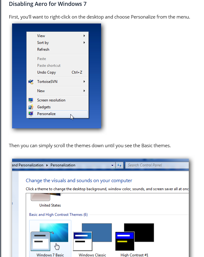

I got rid of nView, there was no change.  Where do I go to shut off things areo?

January 10, 2017
Had to google aero...it's been years. Screenshot for that is attached.
Config.pro (make sure your text editor didn't add .txt ie. config.pro.txt, I've seen this)
If it won't load in your start-in folder. Put it in the TEXT folder in your Pro/e loadpoint. That's also changed over the years and is dependent on your installation. c:\program files\ptc\...  or c:\ptc\... You'll have to search for it.

like the drag window as Stephen mentioned. shut off any thing areo.
a quick start...in control panel find...adjust visual effects and click on "adjust for best performance"
