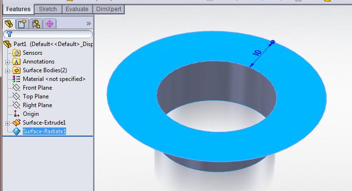

Don't get me wrong. I think more functionality can add difficulty. But, so can not enough functionality. I have to hold that the root cause is how the geometry created is handled by the CAD system. If you have to do a lot of work to set the part up perfect to get the geometry you want that makes it harder to use. If you can do whatever you want and it just works it is easy no matter how many functions it has.
Here is an example. I am not trying to say any CAD package is better then another. This thread is only about Pro/E useability. But, this function came to mind when I was thinking about what could PTC add that would make the software easier to use, but add more functionality.
In SolidWorks surfacing there is a radiate function. It lets you pick an edge and a plane and radiate a surface out a set distance.
If PTC added this it would make Pro/E more complex but would not raise the learning curve as long as Pro/E could work properly with the geometry and you did not have to continually tweak it to get it to work.
So, I am going to hold to my original statement that it is all based on how hard it is to get the geometry you want while staying within what the Tool can handle.
Here is an example picture of radiate if you are unfamiliar:
I do understand that the more functionality there is the more you have to remember to use.
