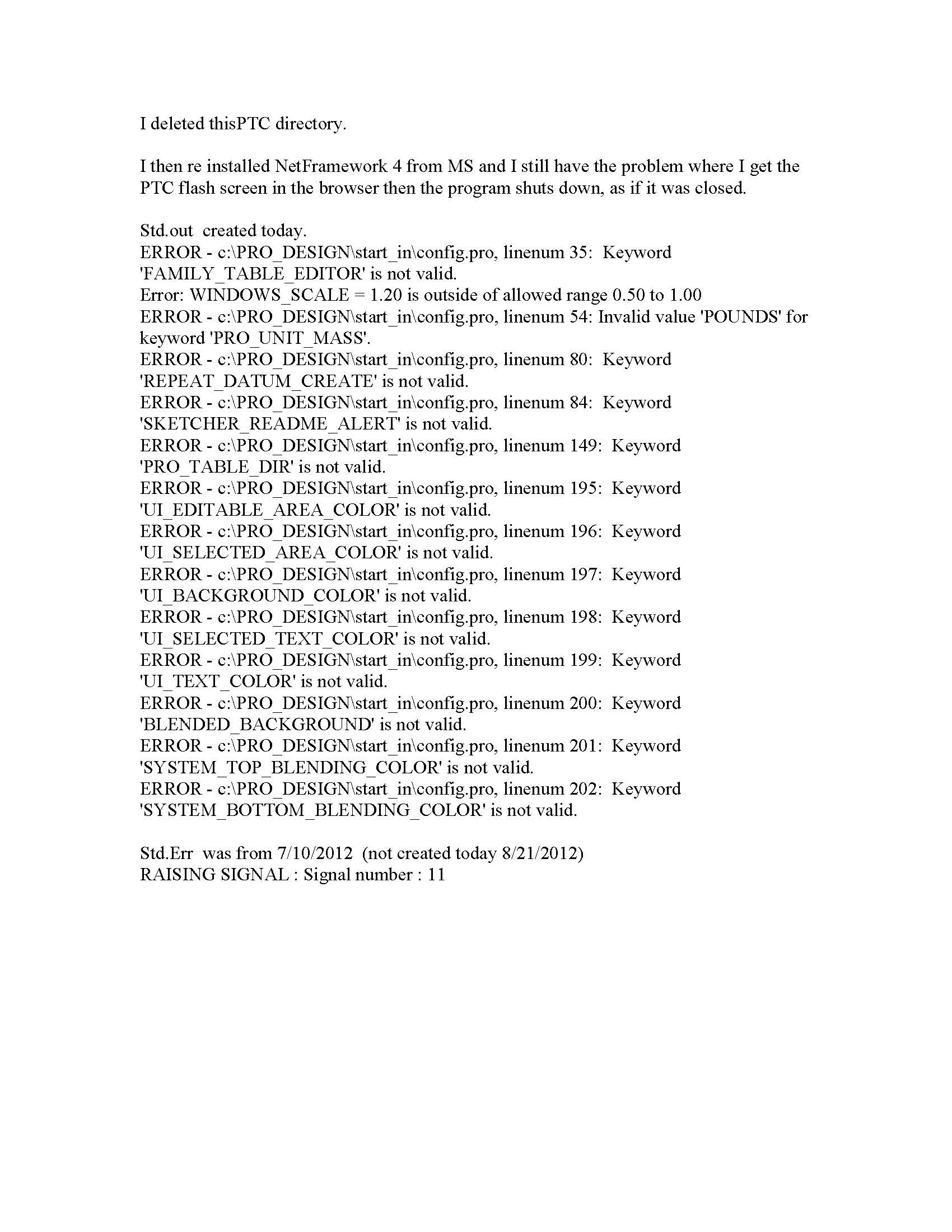

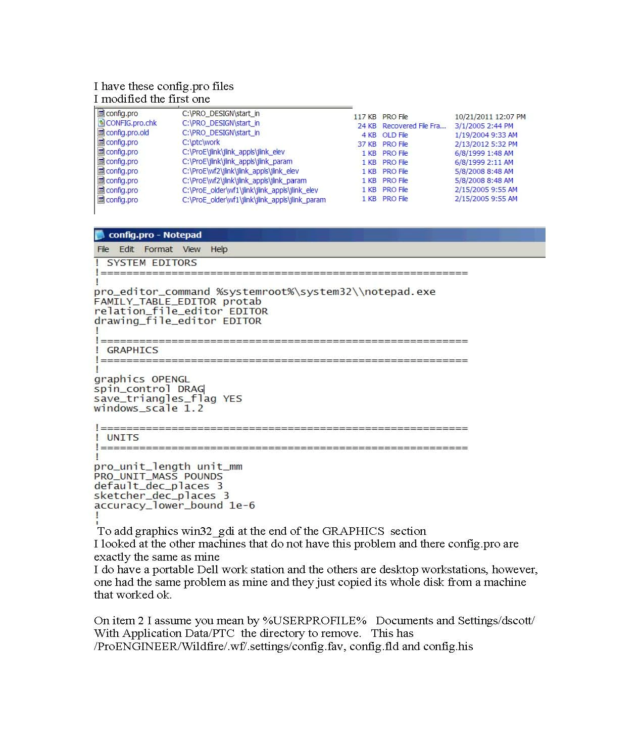

Aug 21, 2012 4:30 PM UTC
I can't seem to copy files in to this editor so I made Pdf's then Jpg's
I hope they are readable
the long and short of it is that I added graphics win32_gdi into the config pro, removed the ptc directory inapplication data
Loaded netframework 4 and still get the splash screen in the browser when starting ProE but it quickly disappears as if shut down.
The other machines that work with framework 4 have the exact same config.pro. They are desktops and mine is a lap top. However one of the desktops did not work and the whole hard drive was copied from one that worked to it and that unit now works.
