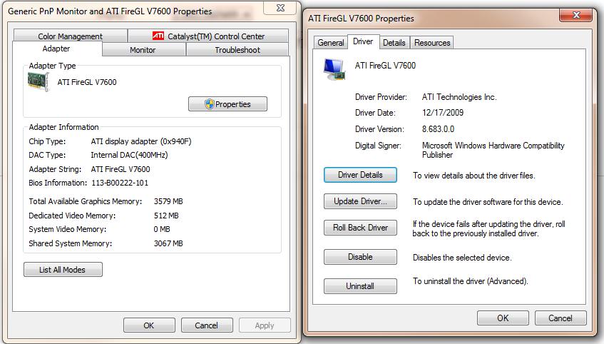

Aug 4, 2010 6:45 PM UTC
Check to see who the display driver is made by. Right click on your desktop and go to properties. If the driver is published by Microsoft it is not going to support OpenGL. You will need to download the driver from ATI or nVidia.
Here is a screenshot of my display properties dialogs.

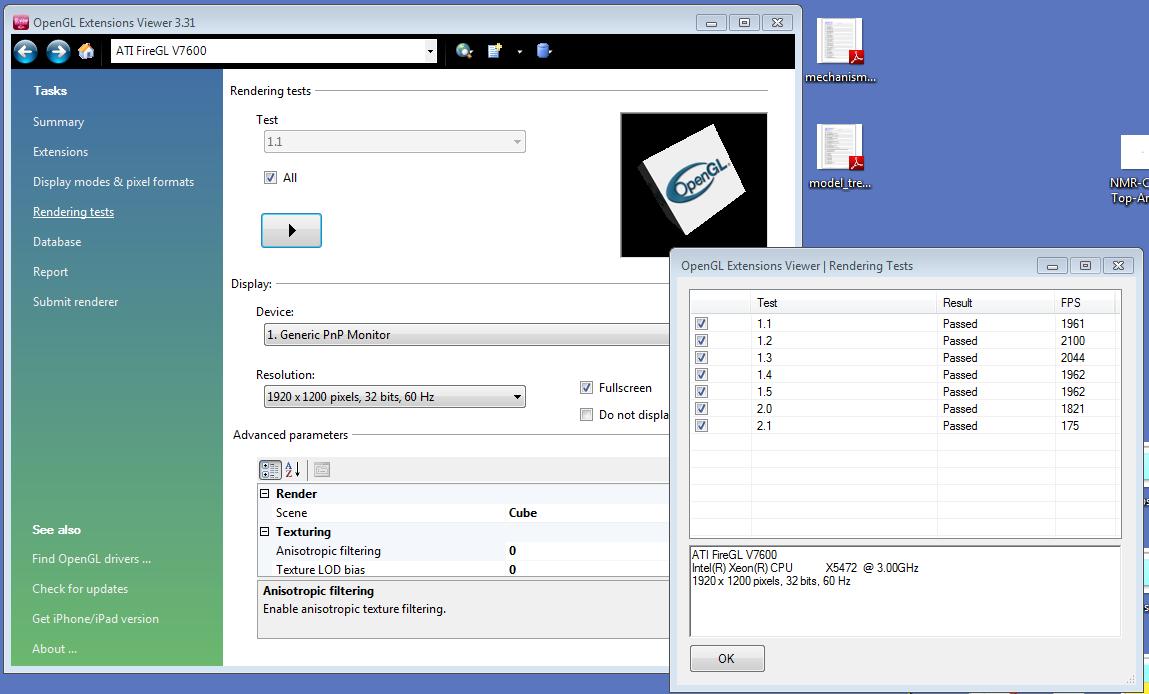

I just found a program that tests opengl kind of like dxdiag tests Directx.
Seems to work really nice. I downloaded it and tried it out.
You can get it from here - it is free: http://www.realtech-vr.com/glview/download.html
Here is a screenshot after the opengl test. Looks like my driver supports forward context 3.0 but not 3.2 (not sure what that means).
You can get ATI drivers here: http://support.amd.com/us/gpudownload/Pages/index.aspx
And nVidia drivers here: http://www.nvidia.com/Download/index.aspx?lang=en-us
Let me know if you have any other questions. What version of Windows are you running?
