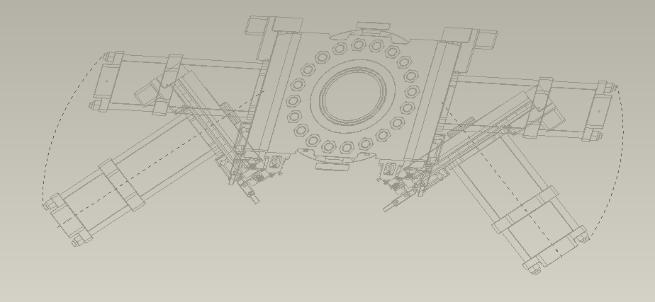

What I've done is bring in 2-d geometry in to a part to show reference geometry.
I create a temp drawing, make a view I need and then export it as DXF, then import the DXF back in to a part. It's exceptional when you use the same reference geometry over and over. Below is an picture of some of my 2d geometry.
I dislike using snapshots or lines in drawings simply because keeping them in the right place in relation to the view can be difficult, relate to view, relate to object, and parametric sketching can help but it's no guarantee of placement.

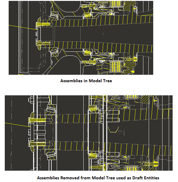

It's just an issue when you don't want to shown hidden lines like draft entities. I've attached a picture of part of a drawing where models are in and have being removed for Family Tree. Ideally want to show view in top picture without assemblies in Model Tree, not having the models there means hidden lines show up  which is certainly something I don't want in this drawing.
I could create the PDF of the drawing before I delete the reference models but that wouldn't be much good for whoever has to change drawing in the future
