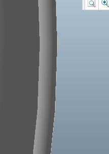

Hi Guys,
Can somebody tell me how to get rid of this problem:
as you could see on the picture above the lines are in teeth form and this is only on one pc in our office. can somebody advice me how to make these lines more smooth.
10x in advance and have a nice day !

    Hi Radoslav,
    Do all the PC's use the same config.pro settings?
    You could try increasing the Anti-Aliasing under Entity Display Settings.
    Off                                                                 On x16

    Radoslav,
    look for differences between your PCs...

    Unfortunately there are 3 more pcs exactly the same (both hardwear and softwear) and i have this problem with only one of them

    Radoslav,
    my suggestions:
    • check version of graphics drivers
    • try to swap graphics cards between PC

    Did you try a higher shade quality in the options?
    July 2, 2015
    yes i did but there is no difference

    HI Miles could you kindly point me to this Anti-Aliasing option cause i cant find it
    10x in advance !
    Radoslav
    July 3, 2015
    In Creo
    File -> Options
    Then Entity Display.
