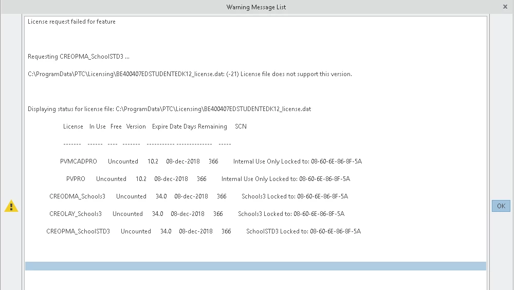

[problem]license is lost
License exist, license os lost...
save, exis, retry
retry> warning: regaines floating license; you can resume working
and not a single mail was answerd from support!
*my network card never goes to sleep
Creo Parametric 4.0 M030 Student Ed.

now that I try to install:
https://www.ptc.com/en/academic-program/products/free-software/creo-college-download/thank-you
pdf: http://apps.ptc.com/schools/references/install_creo4_unistudent_standard.pdf
I get an error when installing with:
BK410705EDSTUDENTUNICL
it just says error after clicking install licence ... sign in....
ehhhh.... 😞

when you get error, look into C:\ProgramData\PTC\Licensing directory. Is there any file inside it ? Can you see BK410705EDSTUDENTUNICL_license.dat file ? Did you receive this file via email ?
If you can see BK410705EDSTUDENTUNICL_license.dat in C:\ProgramData\PTC\Licensing directory, then:
  • uninstall Creo 4.0
  • install Creo 4.0 (new clean installation)
  • do not enter Product Code
  • put path to license file into Source field
  • finish installation

any1 know what te attached file is "saying"
I used: setup-schools.exe
I installed and got this *after a restart and a clean install*
I located the licence, i replaced it with the one I got in the mail: did not work
I replaced it and changed it's name; it did not work.
I replaced just the "text" withought changing the name, nothing.

BE400407EDSTUDENTEDK12 belongs to Creo 3.0 (version number 34.0).
To get Creo 4.0 license,
K-12       students can use Product code BE410708EDSTUDENTEDK12
University students can use Product code BK410705EDSTUDENTUNICL
IMPORTANT:
Do not forget to remove all files from C:\ProgramData\PTC\Licensing directory before you start installation.

1 of 2, the school downgraded/ended the licence
or I had and used creo 4.0 with magic.
when I enter the "4.0 licence nr. I get an error"
whe I install using the setup-schools.exe it installs fine,
but I get the same error message!
Also I get an email saying: .... bla bla:
