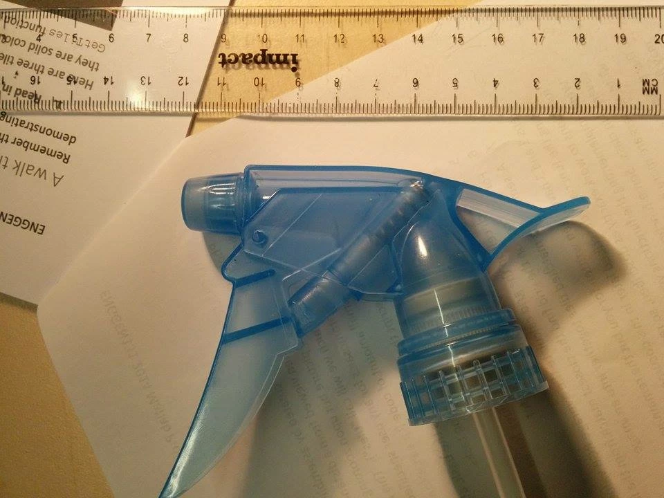

Try this from our Quick Reference sheets:
Add an image (a trace sketch) from external source as .png for use in Variable sweep and Freestyle or for any design work where a photograph or hand drawing is needed as an initial guide. A .png image can be made from a .bmp, .jpg and .tiff via Paint/save as. In Creo View tab >Model Display>Images> Trace Sketch > Add > click FRONT datum plane > Browse to image file > Open > View FRONT > Fit > horizontal >position the dimension > change value to ??mm > deselect Fit and drag trace sketch to centre of workplanes > turn off display of datums > Set Transparency = 0%> Green tick.
