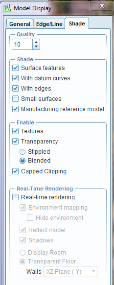

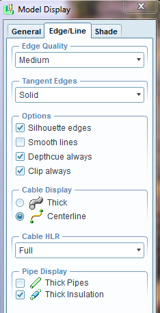

Feb 12, 2013 3:18 PM UTC
Try playing with these settings
