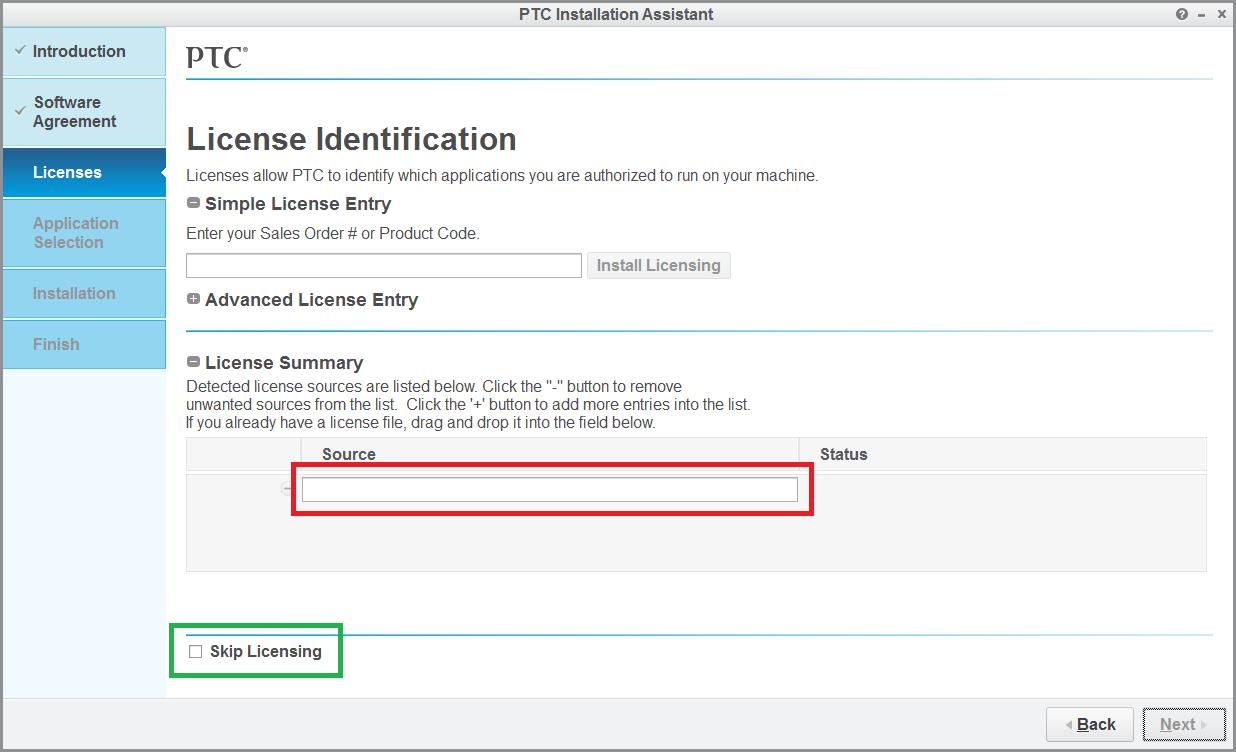

Hi
When my OS was updated to Win10 I had some problems with running CreO 3.0 (student license to Jan 01 ,2016) so I did uninstall CreO 3.0 with all components..Now when I try install once again the software I can not pass successfully the " Install Licensing" step.  I still receive message "Error" The path C:\ProgramData\PTC\Licensing of coure there is with
file BK400..._license.dat from Jan 01,2015.I do not know what to do else. Many thanks for help.
Ludwika

Ludwika,
I suggest you to drag and drop BK400..._license.dat file to Source field. If this causes an erro the Skip licensing, finish the installation and then run reconfigure.exe to define startup command.
MH

October 7, 2015
Ludwika,
I think both files are OK, because current date is inside one year period. I can check their contents, if you can upload them using How to attach file when you Reply to a discussion. I am almost sure that both files contain Student license for the same MAC address.
I tested reconfigure.exe for a while and I am not sure if you can resolve your problem using this tool. Of course you can try to drag and drop license file to Source field...
You can also create startup file manually:
1.] unzip uploaded parametric.zip
2.] move parametric.psf to Creo3_LOADPOINT\Creo 3.0\Mxxx\Parametric\bin directory
3.] check/modify parametric.psf contents
  • line 5 ... SHIPCODE=M040 ... M040 is maintenance release number ... it must be equal to Mxxx mentioned in step 2.
  • line 34 ... ENV=PTC_D_LICENSE_FILE-=full_path_to_license_file ... replace full_path_to_license_file with the current path to your license file
  • line 36 ... ENV=CREOPMA_FEATURE_NAME=PROE_Student () ... PROE_Student is name of the license, you can find it inside license file on after INCREMENT keyword
4.] save parametric.psf
5.] launch Creo
