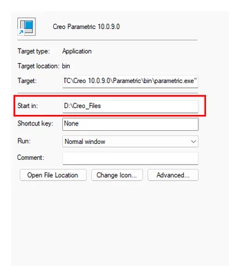

November 24, 2025
The reason could be that the configuration file where the setting is defined is not loaded on starting Creo.
I suggest that you do the following:
Create a Folder say: D:\Creo_Files (just an example. You may have your own name)
Right click on the Creo Parametric Icon --> Properties
Set the value of Start in to D:\Creo_Files.
your Config.pro must exist in the above folder.

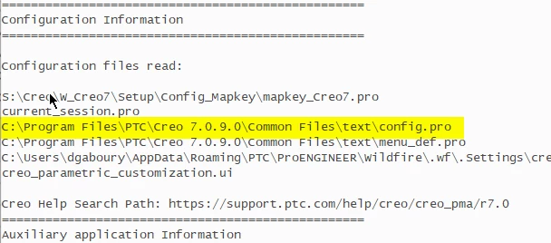

November 25, 2025
Open your Creo session.
Click on File, then Help. Select System Information, then System Information.
In that pop-up window, scroll down to the section:
Configuration Information
Configuration files read:
That will list your configuration files that are loaded at start up.
Check the config.pro file listed to be sure it has the right syntax for your start_model_dir and pro_format_dir.
November 25, 2025
Hi Ben,
Here is the listing of config file read
The config parameter are in the file highlighted.
This config.pro is the same for all users, but for some reason start_model_dir and pro_format_dir doesn’t work
