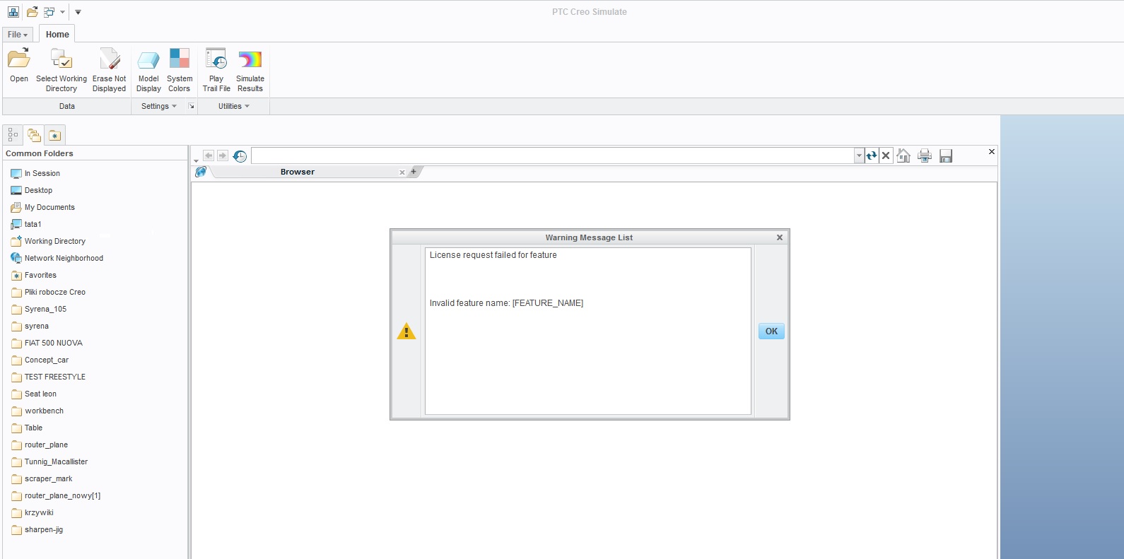

The problem described here Problem with reinstalling license repeats with CreO Simulate. When I try to startup , soft fails down and I get message like on the screen shot.
I have changed cocreatsim file (uploaded below), But I think it is done badly.
I would be gratefull for help.

Ludwika,
none of two your license files available in Problem with reinstalling license contain Simulate license. Therefore you can use Simulate Lite, only.

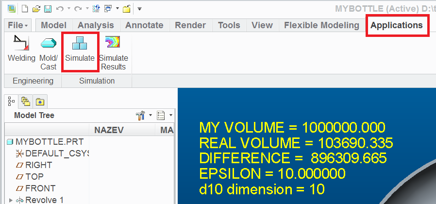

Use this procedure:
  • launch Creo Parametric
  • open part
  • change application from Standard to Simulate
Tomorrow I can upload some pictures, if you need it.

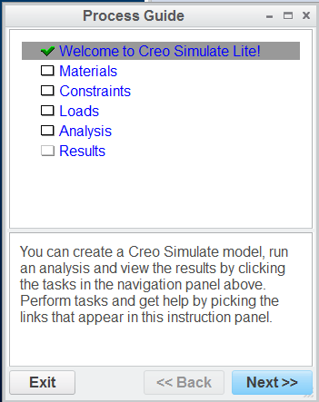

Oct 15, 2015 7:11 PM UTC
Hi Martin.
Thanks to your tips I've got Sim Lite already , and gladly watch your picture
ludwika
Oct 16, 2015 5:00 AM UTC
Step 1
Step 2
Step 3
Step 4
I guess that you have expected different pictures ...
MH
