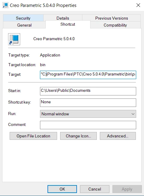

If neither of that works, right mouse button on the icon you use to start creo, click properties.
Look for the "start in:"  That is where the trail files will be if there is no other option.

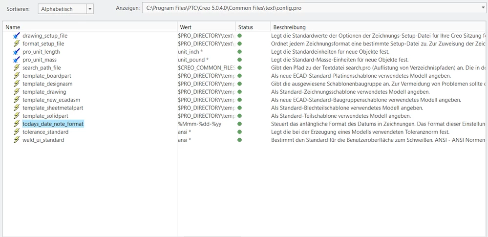

thanks for your help. I deleted the whole Creo Program and reinstall it on the order where creo it wanted. To start by zero . I start the program and looked in the config editor. It shows me only this:Konfiguration.PNG

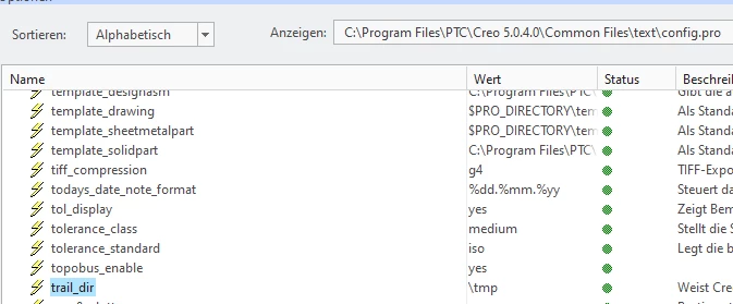

I created an object and saved it. I get again only a Pro_trl.txt. File now with number. Now I insert my config.pro and three other files from my school in C:\Program Files\PTC\Creo 5.0.4.0\Common Files\Text\config.pro
I restart Creo and now I get a trail_dir direction
I created an object but it saved again only a PRO_trl.txt File in C/users/Public/Puplic Documents
and in the tmp stay only out.log. files but not from this program. I changed the direction in C/users/Public/Public Documents but again it saves only PRO_trl.txt. file in this direction. In the config.pro stays
trail_dir\tmp         or         trail_dir  C:\Users\Public\Documents after i changed it in creo.

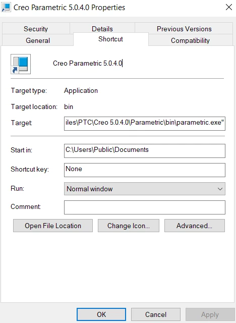

Here you see the properties of creo. Two pictures because the Target was to long to see all on one picture::

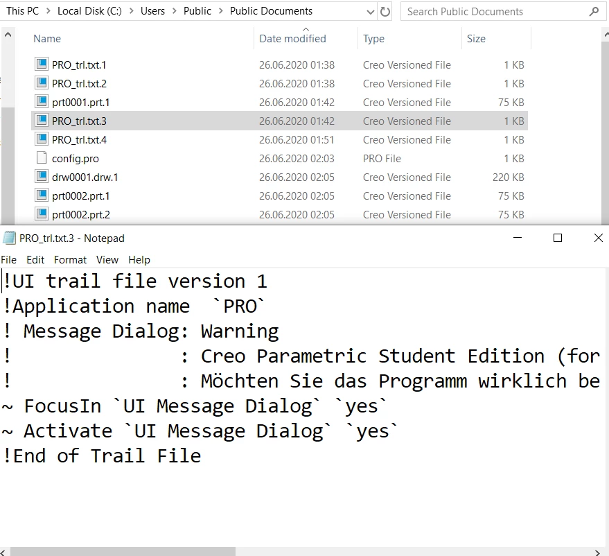

In the PRO_trl.txt. file stay ever this:

That does look like a trail file.
So the way i would test that is I would open Creo, create something, like a square block. save it and exit creo.
Go find the trail file it just create, copy it and rename it to something...test.txt or something, it just has to be different.
open Creo again, go to and load the trail file  and see if it creates the block again. It will happen pretty fast if it works.
