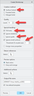

  1. Create a shrinkwrap of the assembly using the following options (file – save as – shrinkwrap)
    1. Surface Subset
    2. Level 10
    3. Fill holes
    4. Do not ignore quilts
    5. Ignore small surfaces - 1%
Always open the shrinkwrap and verify what you are left with. It should be mostly just an outer “shell” of surfaces with few or no internal details.

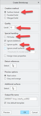

  1. Create a new shrinkwrap of this new assembly using the following options
    1. Surface subset
    2. No fill holes
    3. No ignore quilts
    4. No ignore small surfaces

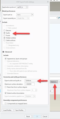

  1. Save as a step file. Make sure you the step options include quilts and in the advance settings, the “export solids and quilts as” SURFACES.
