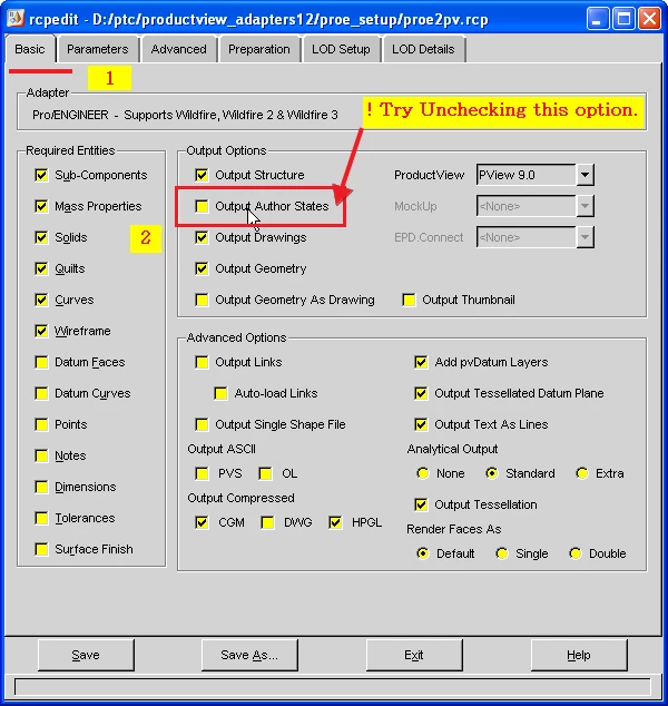

Is there a specific setting within the recipe file that indicates that the .asm and the .prt files be published? Our .drw are being published just fine, but as of last week, no assemblies or parts are publishing. Any ideas? Evidently something has been changed on the cad worker, but I can't determine what. I reset the recipe and config to it's original state, but it still doesn't fix it. The error seems to be on the cad worker - here is the detail from the Publish Monitor:

July 9, 2010
Hi Joanna,
Please check if following works:-
1) Open the recipe file "proe2pv.rcp" found in CAD worker installation folder.
2) On Basic tab un-check the option "Output Author States"
3) Stop the CAD Worker from CAD /Worker Agent Administrator UI. Reload and Start again.
4) Check the result of publishing with above settings.
Refer Attachment. I' ll be glad to know if that helps!
Vabs.
