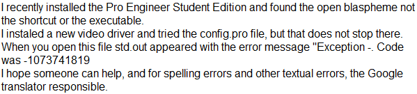

PROE not start

    Thomas,
    put the following option at the end of your config.pro file.
    graphics win32_gdi
    This option turn the graphic drivers off. If ProE starts successfully after this setting, then the problem is caused by graphic drivers.
    In the future please provide more detailed information about your computer, graphic card, and so on.
    Martin

    Please send me the list of files, which are located in PROE\bin directory.
    Martin
