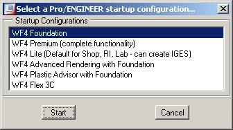

I remember a few years back somebody on the exploder showing some screen shots of a dialog box that popped up when a user started Pro/ENGINEER. The dialog box showed what licenses were owned by the company and how many of each were available to the user. The user could simply select a button to start the license he/she wanted.
Does anybody have something similar they would be willing to share or details of where I could get it?

I am aware of how to set up the different bat files and linking licenses to them but what I would like to have is an interface pop up (just before ProE starts) which tells the user for example, there is a total of 6 Foundation XE licenses 3 of which are available and that there is 3 Flex 3C licenses and 0 available.
This would save the user starting a license of which there are 0 available because other users have got there first.
I hope this clarifies my query.

This?
[cid:image001.png@01CB4E7B.A5CD9A10]
Sep 7, 2010 6:27 PM UTC
You see the dialog box when you launch Pro/E using the proe.exe file.
During the Pro/E installation, you can split up your license files into as
many groups as you need. When you launch proe.exe, you will see a list
showing all the different groups you created during installation.
Not sure if this helps.
