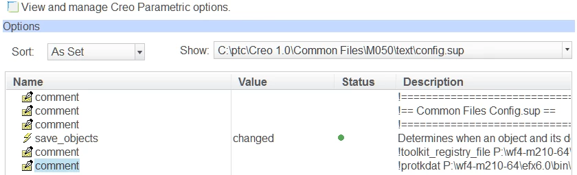

What I did:

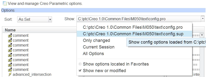

Open the config editor
Select from the pull down the config.sup
[cid:image001.png@01CDBE52.A0E57380]
It now shows me only the config.sup. That is a big improvement!

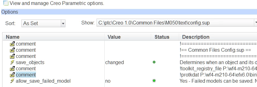

I next pick the Add... button and the Find... button search for something and added it to the config.
[cid:image003.png@01CDBE53.2EC29700]
So far, so good. Looking like I expect it to work.

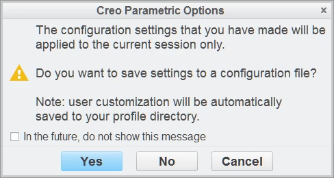

I pick OK, the only button that looks like it will save my edit for me.
I get this message:
[cid:image004.png@01CDBE53.801C1720]
I believe the correct answer is Yes

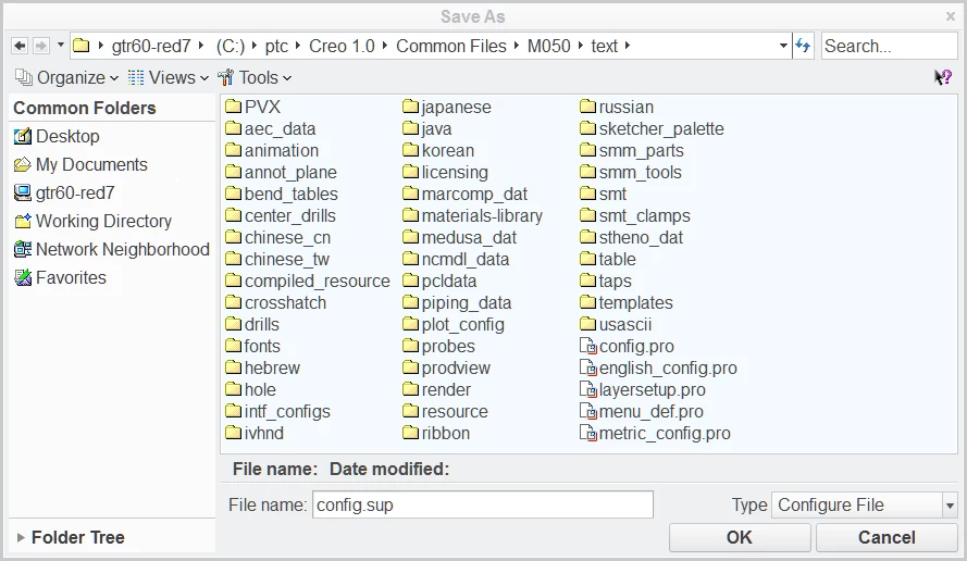

In the save dialog, I had to browse to the loadpoint. And then it would not show me the existing config.sup so I had to type the name in manually.
[cid:image006.png@01CDBE54.9647F180]

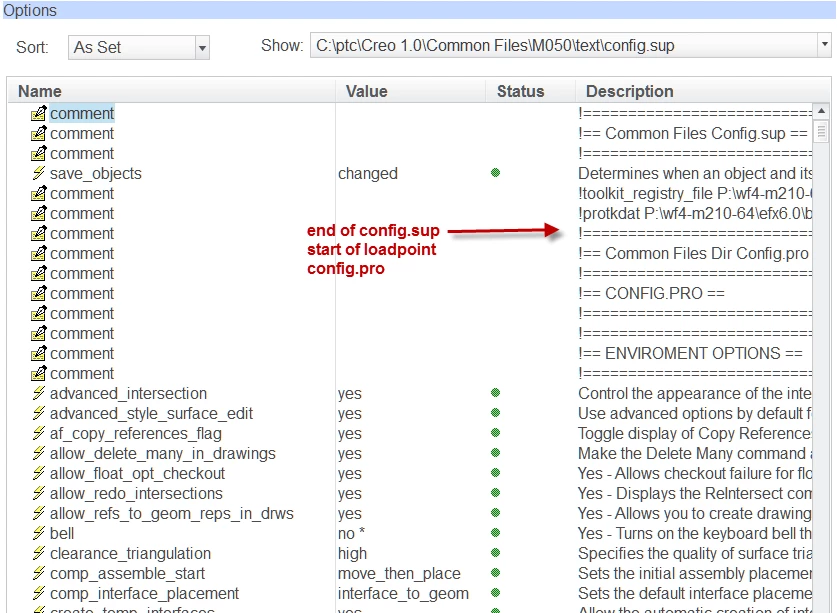

I then go back to the config editor to look at the config.sup again and I see this:
[cid:image005.png@01CDBE55.53DB7000]
My new option was at the end of the file.

Ok, PTC tells me it user error.
You have to pick this menu to export the current config file you are looking at
[cid:image007.png@01CDBE6B.C4346A80]
One caveat, it doesn't apply those settings to the current session. So If you want them in your current session you are going to have to import the config file.
