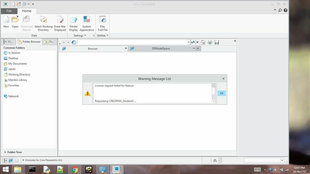

Nov 14, 2017 6:46 AM UTC
Nov 14, 2017 6:51 AM UTC
you have to maximize Warning Message List window to display complete error message.
I guess that your license contains Creo 3.0 license and you are trying to launch Creo 4.0.
