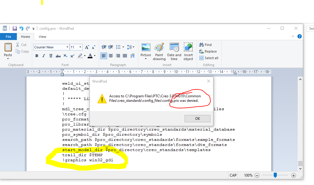

CREOCapture.PNGTRIED BUT ITS SHOWING ME THIS ERROR
August 22, 2016
1.]
config.pro you edited is not the right one.
Please edit this file C:\Program Files\Creo 3.0\M070\Common Files\text\config.pro
2.]
Access denied error message means that you do not have Administrator rights and therefore you cannot save the file.
Suggestion:
> launch Wordpad as Administrator
> open C:\Program Files\Creo 3.0\M070\Common Files\text\config.pro
> edit config.pro and save it
