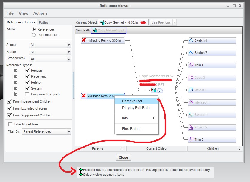

Does anybody know how Pro/E(Creo) handles relationship between Copy Gemetry in final part and publish geometry in original one?
There is an often issue I encounter: copy geometry misses references. I mean fileds responsible for selecting the original part and appropriate publish geom are grayed out and empty.
More, system blocks this area, making selecting new part impossible. There is no further info regarding missing references in Reference Viewer.
Retreive Ref does not work. Any attempt of selection potential parts ends with error message. It seems that system knows how the proper part is named but hide this info for user.

Nevertheless Creo should give me information what Top assembly and what Skeleton it requires to make Copy Geometry ready for changes, to find on the disc, but it fails.1.jpg

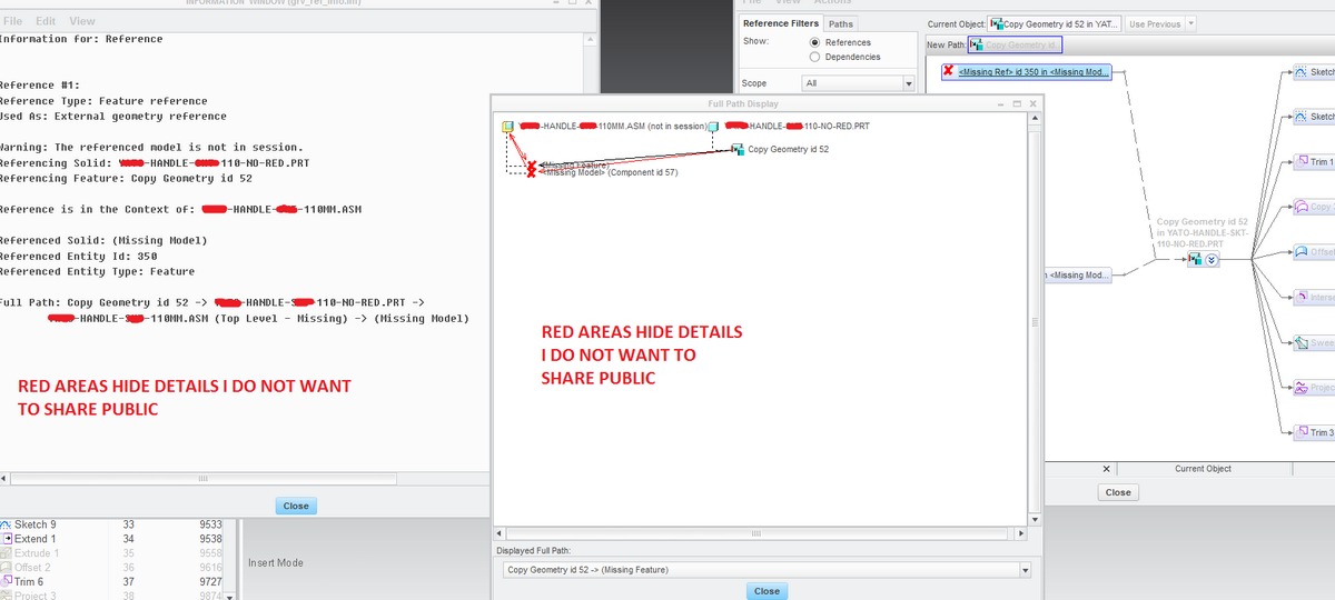

Dec 1, 2014 9:41 AM UTC
thank you for in-depth reply
below you can find richer information regarding references
I used red color to hide some details of names I do not want to share public..
Again - having such infor how would one solve such problem?.
To me Creo should allow selecting new source part and source publish geometry.
Is it possible to write a script in Pro/Toolikt to make such funcionality available?
