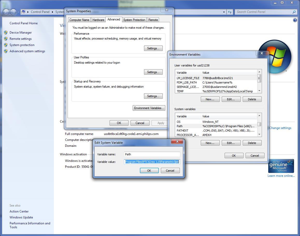

Sep 2, 2011 2:53 PM UTC
My path has this in it: ";C:\Program Files\PTC\Creo 1.0\Parametric\bin".
An easy way to permanently modify the path, on Win7, is to goto the Control Panel -> System and Security -> Systems -> Advanced system settings -> Advanced Tab -> Environment Variables button -> Then in the System variables section find the PATH variable. Just add the path to the bin folder to the end (with the ; in front of it).
The way to it in Win XP and Vista is similar. You can also get to the system dialog by right clicking on "My Computer" and selecting "Properties".
Here is a screen shot.

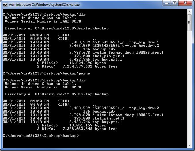

Aug 31, 2011 11:02 PM UTC
You add the path to the bin directory to the system variable "path" then from the command window browse to the folder you want to purge and run purge.bat
